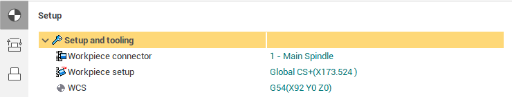

Setup stages
Setup stage is the special group of operation to machine the once placed part(s). If you need the manual part fixturing you need to create another setup stage. A new setup stage contains all the same parts that the previous stage contains. All the parts can be overturned or fixed in another place, but the initial workpiece for these parts are taken as the machining result of the previous stage. If create/destroy/rename a part in a setup stage, it will be created/destroyed/renamed in all the next stages.
The workpiece position is defined by the <Workpiece connector> and <Workpiece setup> parameters. If the setup stage contains one or more parts, these parameters are hidden, rather they must be defined for each part separately. The operations which are inside the setup stage or part group don't have this parameters, meaning that they work with the fixed workpiece (only special Move part operations can also alter the workpiece setup). If these parameters were changed for an ordinary operation in the project of the older version, a special compatibility mode is activated after opening such project, which enabled the workpiece setup parameters for such operations.
The machine (the very first operation of the tree) also has the workpiece setup parameters for the usual mode of working with the single part.
images/download/attachments/95434194/SetupStageParams.png
Workpiece setup parameters in the Setup stage operation.
