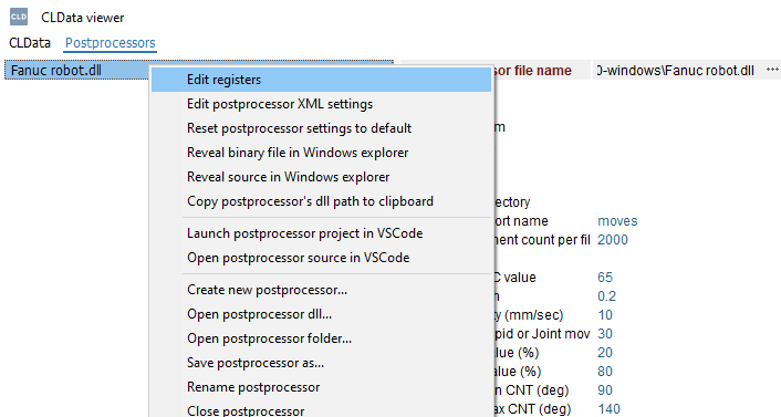

Registers window
Register window allows you to work with registers. In order to open the window, you need to select a postprocessor in CLDViewer, right-click on it. After that click on Edit registers in the context menu.
Registers window displays registers, blocks and files that are stores in Registers.cs file of postprocessor. The window allows you to edit registers, blocks and files more conveniently.

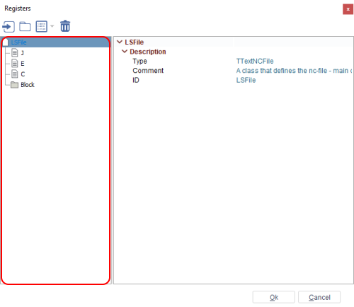

Elements of tree
On the left part of the window there is a tree with a list of registers , blocks and files .
Registers can be located in file or block. You can move registers between blocks in file. Register is moved by Drag'n'Drop. Register can be located either only in the root of the file or in one or more blocks of the given file. You need to move with the key pressed Ctrl button to copy a register from one block to another. Each element of tree has own parameters.

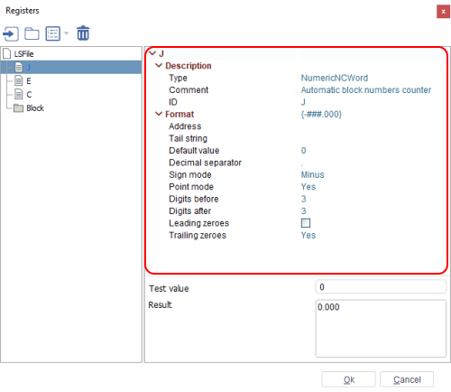

Parameters of elements panel
Parameters of elements panel is on the right side of the window.
There are own parameters for each type of elements.
Parameters of file element
File element has following parameters:
  1. Type - type of output file class:
    1. TTextNCFile - the main class to use for writing text files;
    2. TSimpleTextNCFile - simplest implementation of the output file;
  2. Comment - hint comment for file;
  3. ID - unique name of file class.

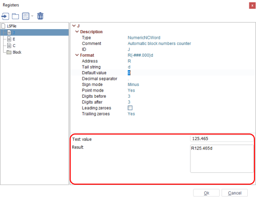

Format parameters of NumericNCWord register
NumericNCWord register has own parameters:
  1. Address - the symbols, which will be written in the NC-program block before the register value;
  2. Tail string - the symbols, which will be written in the NC-program block after the register value;
  3. Default value - default value of current register;
  4. Decimal separator - using "." or "," as decimal separator;
  5. Sign mode - defines the output mode for the sign of the register value. Following options are available:
    1. No - signs is not output;
    2. Minus - only minus is output;
    3. Plus and minus - plus and minus are output;
  6. Point mode - output decimal separator. This field can have following values:
    1. No - decimal separator is not output;
    2. Yes - decimal separator will be output, if the register value has fractional part;
    3. Always - decimal separator will be output anyway;
  7. Digits before - maximum quantity of signs in the whole part of number;
  8. Digits after - maximum quantity of signs in a fractional part of number;
  9. Leading zeroes - defines the zeroes output mode before the register value;
  10. Trailing zeroes - defines the zeroes output mode after the register value.

Test panel
Test panel is located below parameters of elements panel. Test panel is displayed only for registers elements.
There are 2 field on this panel:
  1. Test value - value that will be output based on the specified format;
  2. Result - example of displaying entered value based on the specified format. Five values ​​are displayed for the register, since this register is incremented with each value.

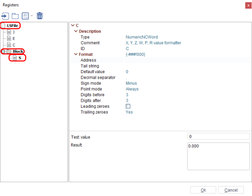

// This file may be autogenerated, do not place meaningful code here.
// Use it only to define a list of nc-words (registers) that may appear
// in blocks of the nc-file.
namespace SprutCAMTech.SCPostprocessor
    ///<summary>A class that defines the nc-file - main output file that should be generated by the postprocessor.</summary>
    public partial class LSFile : TTextNCFile
        ///<summary>The block of the nc-file is an ordered list of nc-words</summary>
        public NCBlock Block;
        ///<summary></summary>
        public NumericNCWord S = new NumericNCWord("S{-###.###}", 0);
        ///<summary>Automatic block numbers counter</summary>
        public NumericNCWord J = new NumericNCWord("{-###.000}", 0);
        ///<summary>External axis value formatter</summary>
        public NumericNCWord E = new NumericNCWord("{-####.000}", 0);
        ///<summary>X, Y, Z, W, P, R value formatter</summary>
        public NumericNCWord C = new NumericNCWord("{-###!000}", 0);
        public LSFile(): base()
            Block = new NCBlock(
                  this,
                  S);
            OnInit();
