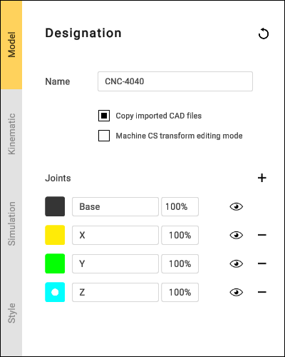

Mechanism name and type
It is necessary to enter Mechanism name. MachineMaker uses 3D model filename as default name.
